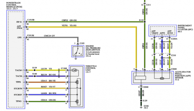

The throttle body - it's condition needs to be inspected - does not always mean replacement.
The Throttle Body connects itself to the PCM - so does the Throttle pedal - but they don't directly connect, he needs to check to make sure that a voltage is getting to it, and the ground from it - is working - back to the battery Negative.
He needs to verify that Ground on the Throttle is also the SAME ground the Pedal uses - an ohmic variance above 1 ohm is suspect then to be a faulty connection or intermittent Ground connection.
Same applies to finding a voltage in which to power both devices - needs to be close to the same voltages measured across to their respective ground terminals - at their connectors
They are not infallible though.

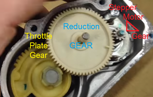

The Logic board in them is pretty simple - and the motor itself uses a stepper design - so you don't want to put your finger in the throttle vane - when its' operating - you may not get it back (pinch point).
The gearing it uses from the stepper motor is unique - a reduction of a 360-degree rotation motor to a 90-degree plane - that reduction is 4:1 - so the logic motor itself has a wide level of rotation - and it only has to turn so many degrees or steps - to open the throttle from the rest to the idle. So, it actually has a rather wide angle to turn to make Idle speed open.

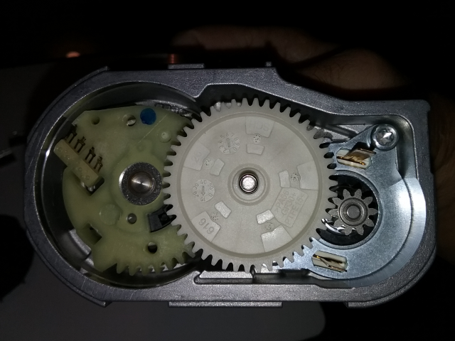

In the above screen grab - the throttle place "location" is determined by the
that 4-vane cross in its center. - using a Hall-Effect device (magnetic sensor)
- others have a carbon trail using high to low and low to high ohmic measure
- that where they meet, is considered the angle the throttle plate is at.​

Actuator circuit A - is the stepper motor controller - but to register the motion, requires it to see the value of the throttle by it's location - so if the gears are showing wear or the intake needs cleaning - this doesn't always set this code - so to me thing may indicate internal issues - not just a simple range issue.

The problem sounds like the gears in the throttle assembly slipped a position of gear (a cog) affecting where the stepper motor would stop at once it thought the throttle was closed - or closed sooner than expected - which sets that kind of code. Actuator A is one circuit you can think of that "Drives the motor to this position" once the throttle is released, another actuator and a return spring then work to pull the plate back to the original position of idle - but in the meantime the stepper motor is also sending information about where it's angle of rotation (the known last reset important) is, and the system tries to put it there.
If the gearing slipped a cog (most likely) it can lose aspect of where the stepper motor is, and the throttle angle while driving - which then the system will see this as a logic failure and place it in limp mode until one of two things - the throttle and stepper angles are figured out - or a complete reset and or relearn occurs. You can't do both when the engine is warm, but you can clear the code if you pull the battery cable and using some method to short out the positive to negative cables - but not at the battery.

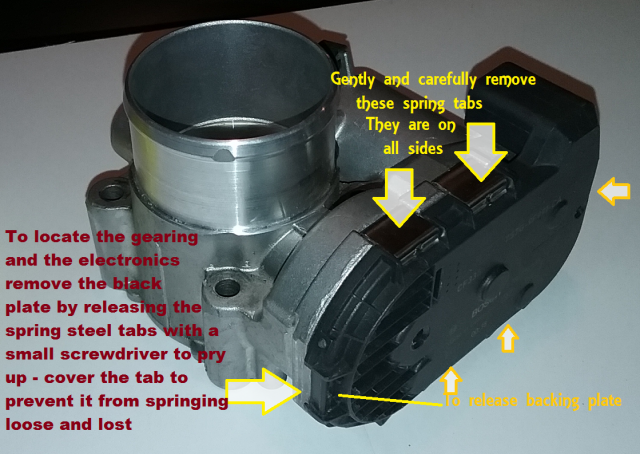

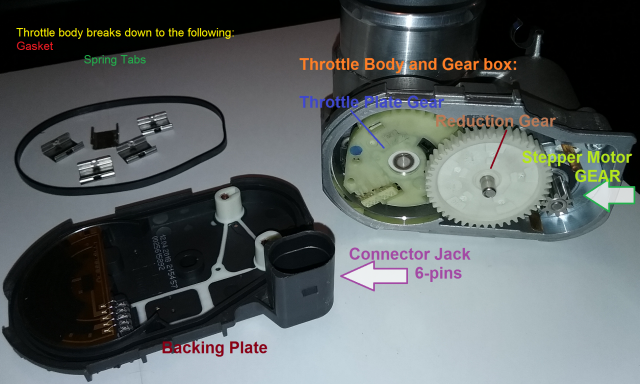

First remove the throttle body from the intake.
Remove the spring tabs
It breaks down to this...

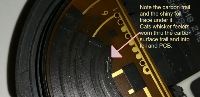

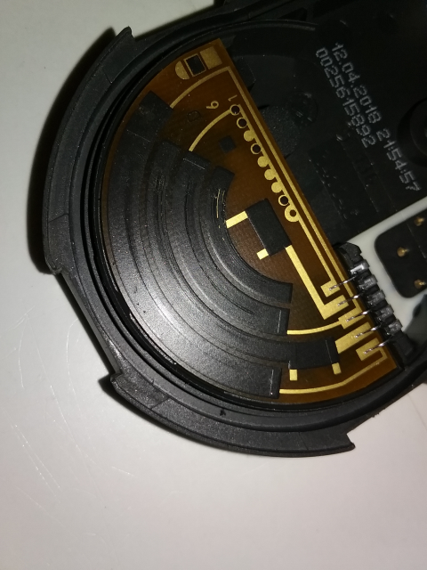

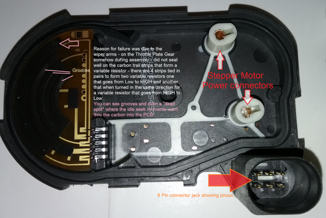

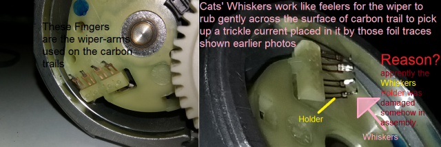

Here's a closer look at the backing plate and the part I wanted to address about another condition
wear, that can generate the same results in codes.

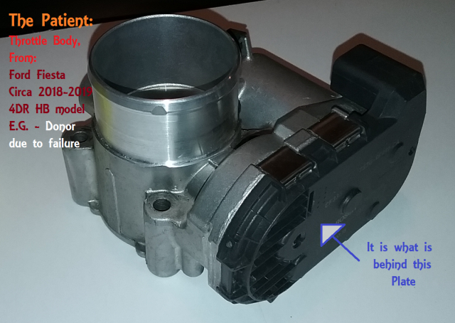

The above throttle body you may encounter in your 2017 Focus. Both can be used in specific model and trim lines because they give similar outputs. But the one shown in the EARLIER post is the one most common on earlier model years - they then switched to this construction which has its own problems - one main one being this...
Not sure of how this got to be - but I left it alone and just got another Throttle body to replace this one and took care of the problems I had in drivability.
I use the throttle body as a template to help me find dimensions I may need later - the gears appear fine, and the larger central Reduction Gear can be pulled off - it's symmetrical so the gear can be placed back on in any given angle of mesh - the critical components are the throttle gear and the stepper motor and its gear
It's just sad to see something like this. I bought the car new; it raises questions - was this some big experiment for someone to play with? Although speculative - yes, I can't explain the failure except for poor assembly problems or a quality control issue or someone just got funny and swapped out theirs to replace with this.
So as you work on your car, let the tech know of these two types I came across - but both output similar variable voltages for the PCM to figure out where the throttle is and how to control it.

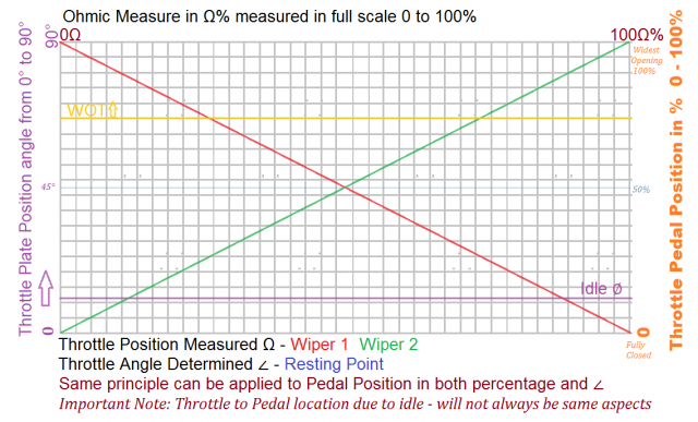

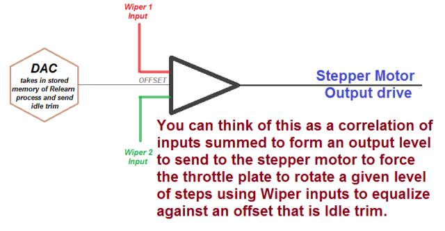

You can print this out to help you figure out where two values meet in an X - Y axis.
Then the system sees the two values and plots it - using the inputs as a means to plot where
the throttle is compared to the pedal location - where the two meet sends the system a signal
of what and where the throttle and pedal are and where it needs them to be.​
The Throttle pedals are similar, using a twin carbon trail wiper construction. But please be aware that it's twin output levels - one goes to the PCM, the other set goes to the DASHBOARDS Pod system connector for its display of RPM - it's also got PWM (Pulse Width Modulation) output for the RPM needle to "count" against and display the expected RPM - meanwhile that variable side - the PCM calculates the throttle angle and what it needs the angle to be using the Carbon trail in the pedal and the wiper output from the throttle to determine angle.
The failure can be thought of as an assembly issue, but your codes got me to repost data that somehow got removed from earlier times of posting - I was building a set of posts to help me and others find resolution for specific problems - this was one of mine that in my first time dealing with Drive By Wire (DBW).
