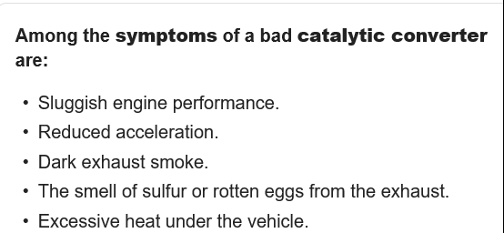

Looks like you covered the ignition side. Any of these signs? kind of sounds like the engine is having trouble breathing? How many miles do you have?
