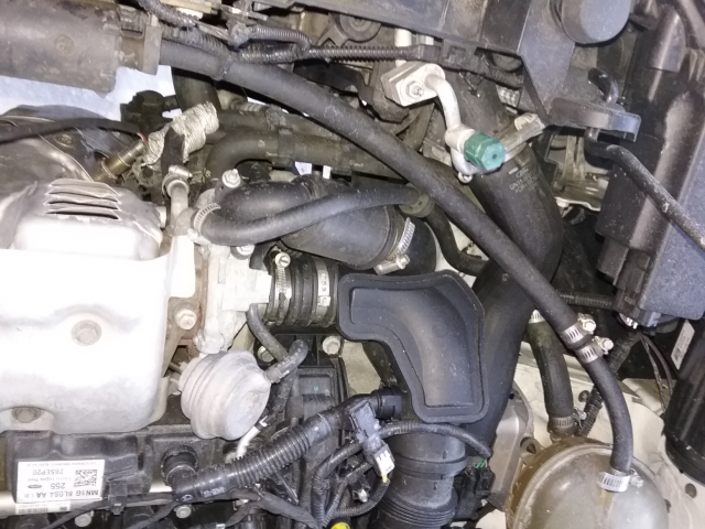

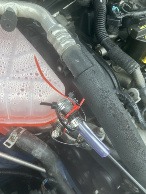

The 1.0 has some specific issues with its design that requires two separate thermostats, malfunctioning of either one of them being catastrophic for the engine is a major concern. All the other engines have a very “age sensitive “ coolant reservoir and plastic coolant lines. Just last week I found out that the coolant lines and their connectors had reached the limit of their lifespan. When I went to replace the coolant reservoir the connectors to each cooling line literally crumbled as I disconnected them with my bare hands!
The result being a cobbled up fix that took a while to complete so I could use my car until new lines come in. Failure of any of these components is a huge concern a blown engine kind of concern.
2,009
1,393

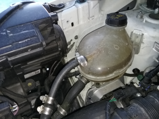

Seems to be a chronic problem, just recently drove a 2018 EcoSport with one of those 1.0L - they had a similar issue with broken clips.
They wound up using those threaded hose clamps - I could not believe the OEM clamps failed that fast...

The small diameter plastic lines are original to the car. So, I have to call their lifespan to be eight years.
it will cost over $140 to replace the two plastic lines I am looking to fabricate equivalent lines in metal or aluminum but I have not inspected the other ends of the lines yet to discover how much trouble they will be to replace. I might “chicken out” and just buy the OE parts and then do a protective thermal wrap on the ends of the lines. Then at least the external heat soak will be slightly less. But I don’t like the idea of the plastic lines and clips.
