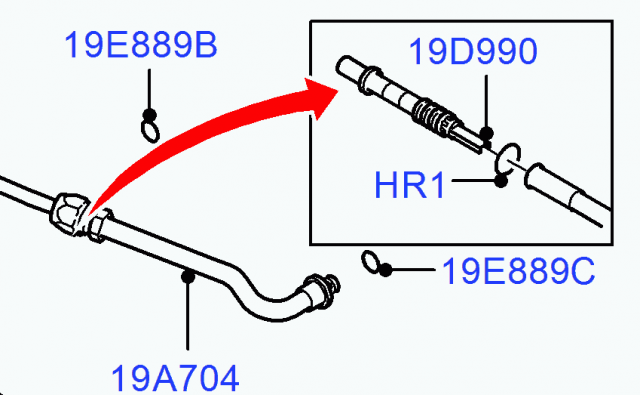

There are several things that can go wrong, up to and including the compressor, but two others are not mentioned often but might need to be inspected.
One being the FREON level - it needs to provide pressure to even work, don't want the system to engage a "Dry line" for it can damage the pump if not already dried out from lack of freon and its carrier agent lubricant.

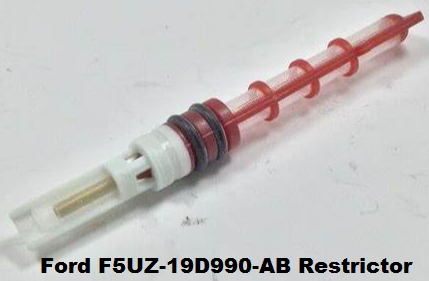

Another is the needle valve that causes the constriction, and the expansion of the freon thru that nozzle...
Your valve Reference may vary, but this gives you the idea.
