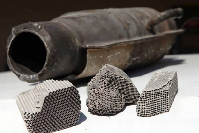

Another is from the catalytic getting damaged by road debris, it can dent and crush or break the honeycomb structure that has the catalyst conversion metals that do the actual process - rendering it less effective so the system sees less of one type of fume in the exhaust, and more "raw exhaust" meaning that the O2 sensors are reading about the same value - tells the system to look for problems.
