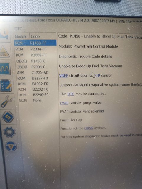

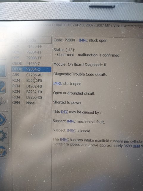

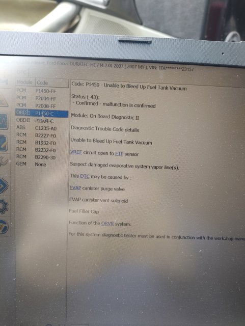

Having an issue with low idle (will occasionally stall) and trouble starting up when weather is cold (difficulty getting it to start at all as the temperature has continued to drop)
The code displays a P1450 code which describes as "Unable to bleed fuel tank vacuum" (Further description in attached images) I was wondering if anyone has had similar issues, I'd like to troubleshoot the problem with hopes to replace the faulty part and avoid having to replace the entire EVAP system. Any help is much appreciated.
