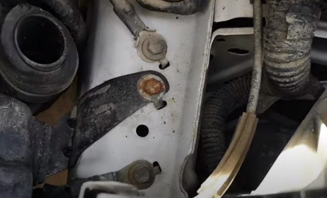

Might want to roll up your sleeves and get dirty fixing rusty grounds.

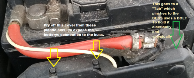

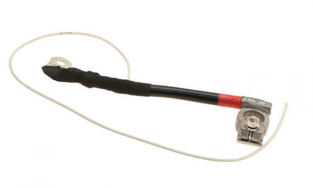

If your Battery posts at the Battery are fine, are you double checking the grounds the vehicle will use to return the power back to the battery?
The above? Is your POSITIVE battery post jumper that feeds into the main "buss" to the fuseblock
Here...
While you're at it, remove the battery and even the Airbox (Air Filter assembly) and expose the Body and Frame grounding points.
Might want to clean them up see if it can recover. - would not hurt to review the vid this comes from...

Why does this become a concern, age and oxides. IF you see rust, it's already working on degrading the performance of your vehicle electrically, which then changes the level of power presence for the battery to supply power it once had to the system.

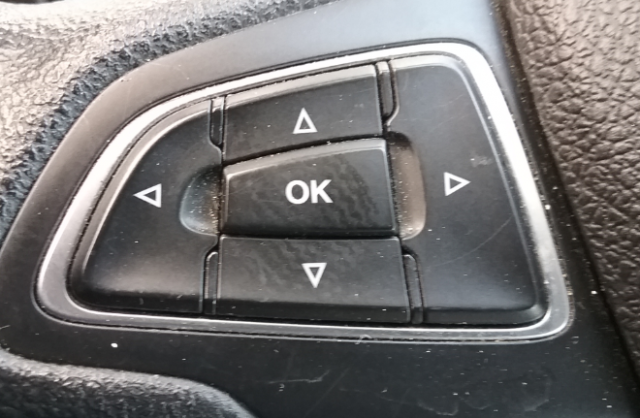

Locate your LEFT SIDE "OK" and menu scrolling keys...
Insert your Key into the IGNITION...PRESS and HOLD OK - then turn it (Your Key) to ON (Run - not Start - yet)

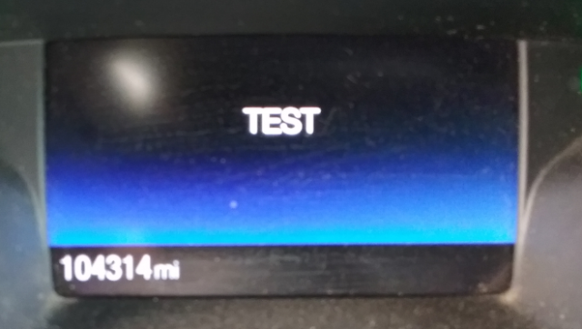

Soon you'll see this...
in your front panel Display Box (your HEC)​
Release the OK button, use the Up and Down Scroll buttons on that LEFT side to find various pages of information you may find useful - including this one...

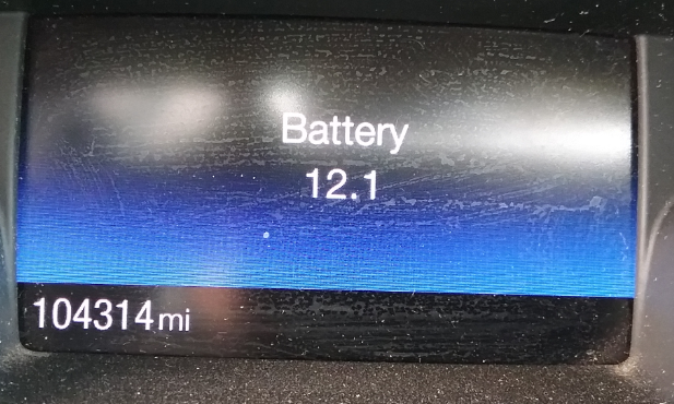

This one can help you decipher issues with Electrical.​
This value is when the engine if OFF not running - you can "Start" the engine now, and watch this value change as the engine runs and the alternator then takes over the regulation and charging. This value should go up to 14.2 to as much as 14.7 - this is what the System sees as a working voltage.
Now that may be fine for a sunshiny day with no rain and the AC off and your not running the blower on high trying to defog the windows and or keep you cool.
So, turn it on, those accessories and headlights too, while you watch this value - it should stay close to the same value as you had stabilized to before the electrical loading test you performed.

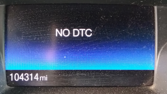

Once you have those answers, then scroll thru and see what that Check Engine Light was all about?
If you see the above - Celebrate!
