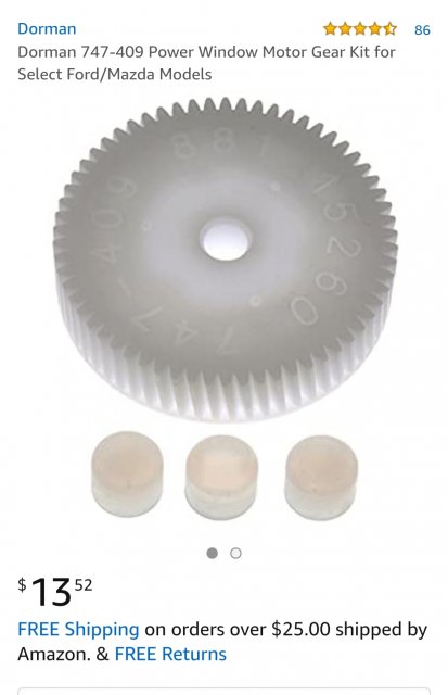

If you are hearing the regulator moving, the parts may need replacing... and they are replaceable. I did my old Explorer, but I hear the Focus uses similar parts. I attached a picture of the parts because I don't remember the names. When the regulator went ot on my Explorer the new regulator cost was over $200. I decided to pull it out and took it to my mechanic. He told me to buy the parts myself and put them in to see if it works. I did, and it worked for the remaining 5 years I had the car. It's easy to do just make sure you use plenty of grease. Side note, while you are in there make sure the other parts are good. Side, side note... try to find the parts that are plastic/ metal so they last longer.

I don't hear it moving, I hear it click nothing more

So an electrical clicking, not a motorized clicking. Pull your panel off and check the current. Hopefully it's just a bad contract, worst case a bad regulator. It seems like you checked everything else.
