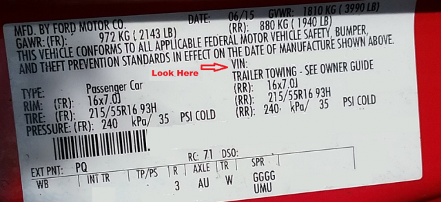

As far as ID'ing the "model" look for a sticker on the Drivers side door - to the front - on the chassis itself in the well of the door jamb.
Kinda' like this...
Or you'll have to locate the REGISTRATION for the vehicle and use that for your research.
