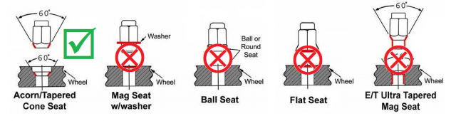

But the seat configuration you're looking for is called "Bulge Seat" style. Also known as Conical.
To use the word "Bulge Seat" is for the use in USED wheels - and new.
When a wheel is driven on, then removed and its tire replaced then placed back on - some wear at the seat occurs during the lifetime of that tire that was used on it. The seat - it can deform enough to make the wheel wobble - so the "Bulge" seat types are slightly oversized to handle the seating and proper torque needed to keep the wheel to the hub and you on the road.

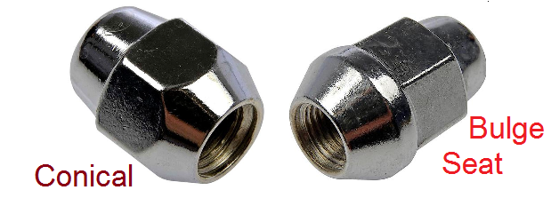

To Help: Notice the "Bulge Seat" style
is slightly oversized compared to a typical Conical style

So conical and Bulge Conical and Bulge Seat - are adequate - but when replacing these Wheel nuts, remember that if you put them on, you become responsible for their proper torquing and use.
