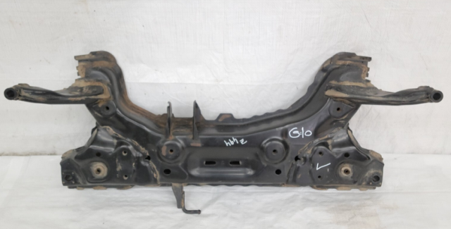

Engine carriage - where those mounts bolt to, are they in good order? No cracked arms from the carriage to the body?
Bolts from the carriage to the body ok?
Any particular rattle when you drive on smooth, transition to gravel road - type of rattle - arriving from the floorboards?
Why do I ask?
It may not necessarily be Directly from the engine but as a built-up shake from a resonance from the RPM - long term steady RPM can induce a fatigue failure - torn metal - like a frame member - caused by a harmonic resonance..
The carriage itself mounts to the wheel-well both sides but also to where your control arms and the main cross-member meet. This is towards the rear of the motor and just under the driver and front passenger seats floorpans.
Other sources of the vibration can come from the engine mount locations - like a crack in the frame to bolt where the side mount towards the front of the motor side - where the serpentine is at - can break. You may be able to even feel the vibration travel thru this mount and stop where the break is at - being that the break frees the motor from any form of dampening from that point - so it really shakes like a tuning fork - in that area - due to that specific RPM making it "sing"
And as you carefully place your fingers from the frame bolt areas towards the mount at where the frame to engine mount meet in that area. CAREFUL OF PINCH POINTS - you may be able to locate it - the Frame and engine sides of the mount don't move in sync with the resonating vibration - you can replace the mounts but if the mounting location itself is fatigued - then the cars own ability to be driven is in question - cracked frame or carriage,
