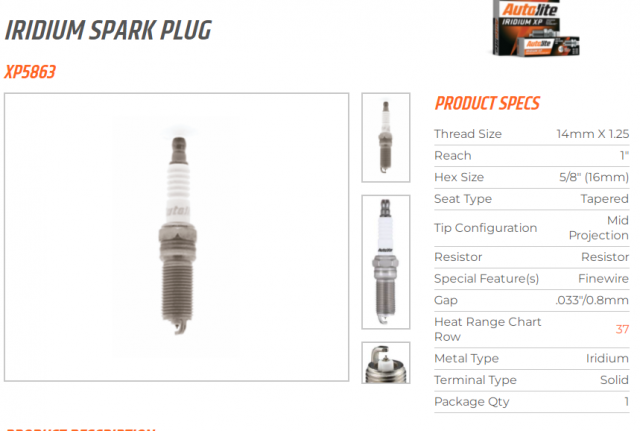

Well, let's see...
The two are identical - only the "Gap" is changed.

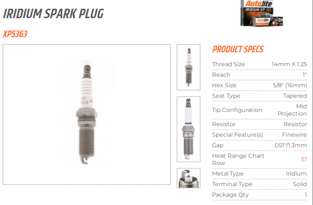

The 5363 gap is greater - larger, but to help you understand this - requires a bit more physics but the electrode gap is larger meaning it requires more energy to fire - which can lead to mis-fire due to the effects of compression - meaning the air/fuel charge when the compression stroke occurs, may cause the misfire - becasue the larger gap would also look like "wear" of the spark gap of a typical spark plug - it's harder to form the arc when the gap is bigger in compressed atmosphere than it is in sea-level "free air" (10:1 compression versus 1:1 sea level)
So, if you reset the gap to the 0.8mm then you are fine, leave them in.

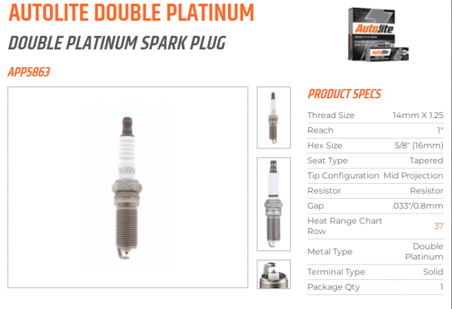

Now the APP - for the plug you thought you should use...
The only benefit I see in using Platinum is in the emission side of things. It's part of the Catalytic converter as processing the burnt fuel by providing a "carrier" as part of the catalyst process of exhaust to O, C and H from HCO in the exhaust itself - helping to break hydrocarbon bonds to revert it back to their basic elements. Iridium is simply a harder metal, so it lasts the longest - at least they claim to have it survive up to 120,000Miles (YMMV)

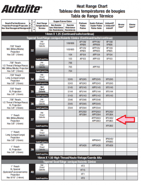

As you can see, they all use the "same" heat range - so the plugs will survive and not damage the cylinder head or the pistons in any way by dimension or by causing fouling or excessive knock from being the wrong heat range in itself.
Series 37 refers to construction and it is a "hotter" plug to help burn off the electrode deposits and keep the "soot" that would be left as a deposit from becoming something it can foul on and mis-fire. (again a gapping and debris issue)
This may be more information than you need, but this is to show you, you did not do anything wrong in selecting a longer life plug.
