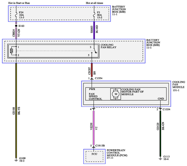

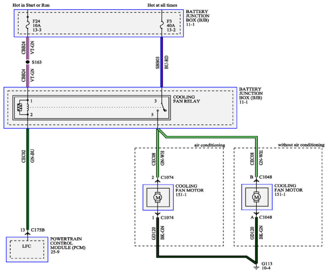

My son’s 2014 Focus SE was leaking antifreeze from the radiator and overheating. So I did the obvious first thing by replacing the radiator. It’s still over overheating after about 25 minutes of idling with the AC on. One thing I noticed was that the engine fan doesn’t turn on. I verified it still works by hooking up directly to the battery and the relay is still functioning properly. Looking for advice on what to try next. I’ve already done the following:
• Replaced the radiator
• Replaced lower and upper hoses
• Replaced thermostat
• Verified the engine fan still works
• Verified the fan relay is still working by ohming it. It was about 72 ohms.
• Made sure the fan plug was well seated into the fan receptacle
Anything else I can try? I appreciate any feedback.
