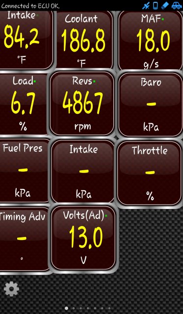

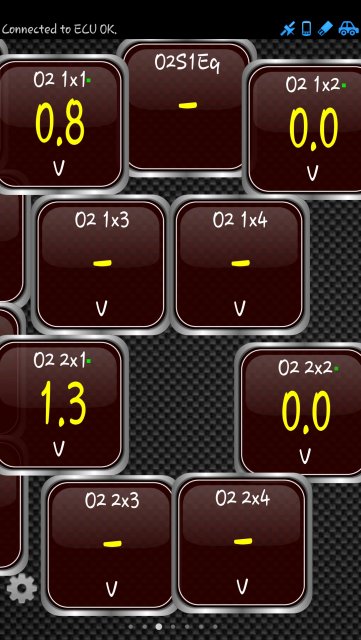

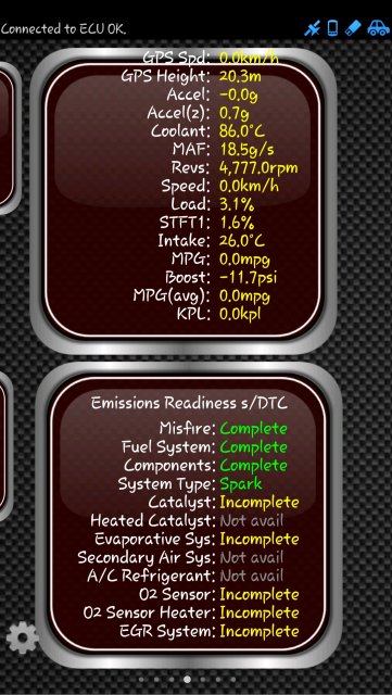

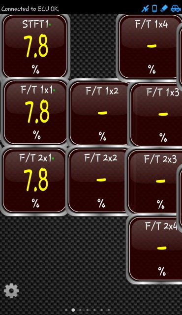

I have a Bluetooth scanner that I can read all the sensors with, the voltages read as soon as I plug it in/start it. I did notice when I unplug my tps, there is no change on how the engine is running though.
The car ran fine until I replaced the starter, in doing so I pulled the intake manifold, and then had to replace the throttle body after cracking the original when trying to remove it.
I have checked in every possible way for vacuum leaks, but with the RPMs up this high, it would have to be a huge frigging leak, and I'm not finding anything using starting fluid.
